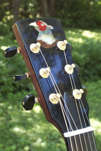

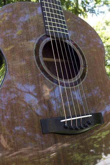

I just finished this for a guitarist who is also an avid hunter. He wanted a guitar that was not too flashy. (so I had to restrain myself) We went with a IRW/Sinker Redwood combo for a dark, understated look. And a Ringneck Pheasant for an inlay.
It's only just recently strung-up, but so far, it sounds very balanced, but with a big bass, (I think it will sound really good in lowered tunings).
The Ebony came from RC Tonewoods, Thanks Bob!
Binding is off-cuts from the sides.
Rosette is off-cuts from back.
Neck is Walnut/Bocote/Walnut/Bocote/Walnut.

Oh! Cool!  What a great looking guitar. Beautiful Redwood top.  Killer inlay on the headstock. Thanks for putting that up for us to see.

Did you do the same thing with top thickness and bracing as you did with the guitar you had at ASIA ?

Mark, this Redwood top was only .120 - .125 when I got it, so I had to approach this one a little different, it finished at about .110 and I used Sitka braces instead of Cedar. It's scalloped X bracing with two angled tone bars.

Real cool Long!  What do you use for red in your headstock inlay? Rich

Very cool ringneck pheasant inlay Bob! I used to hunt them back when I was growing up in Ohio.Very tasty. Great looking guitar overall!

Rich, the red in the inlay is bloodwood.

Beautiful work Bob. You must have been working on a couple at once because I've seen you post some sweet looking guitars over the last few weeks. I do have a question for you. You mentioned that because this was a thin top you used sitka instead of cedar bracewood, why would you normally have used cedar for your braces? I've only worked with sitka tops and braces, so any info on material selection would be appreciated.

I don't really use cedar or spruce bracing for any particular top. (Yet) But I have been switching between the two in an effort to develop a sense for what the difference might be. I've done deflection test between the two and they seem to be pretty close to the same.
So far the only thing that I can say with certainty is the cedar bracing makes the guitars smell nice.
The guitar Mark mentioned had a Lutz top that finished around .145 and it sounded really good, I've been going more in that direction... thicker tops and lighter braces. I think this keeps the tops from getting some of the deformation you see in tops that are thiner.

But I think the rosette looks particularly appropriate.

That's a cool inlay on the headstock...very cool!!
